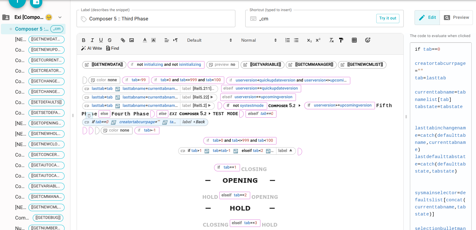

Hi, I stole this one to :slight_smile: just a question, is it possible to make the "back" button to only go back one step and not all the way back to base?
Yeps! you could change the "currpage" to which page you want it to go.

I think I got it, I need one "back" for every page? Can't have one "static" button?
That is actually possible, however it would be kind of harder to explain as it depends on how your snippet works. Here is how mine is set up.
This is like Master class degree in textblazing. I am on noob stage still, so I am sticking with the "one button" for each page for now. Ty for the help though :slight_smile:
Yep lol. So here, I have made some modifications to make it only have one button, kindly try to like study or understand how it works and if ever you have a question, feel free to drop it here.
