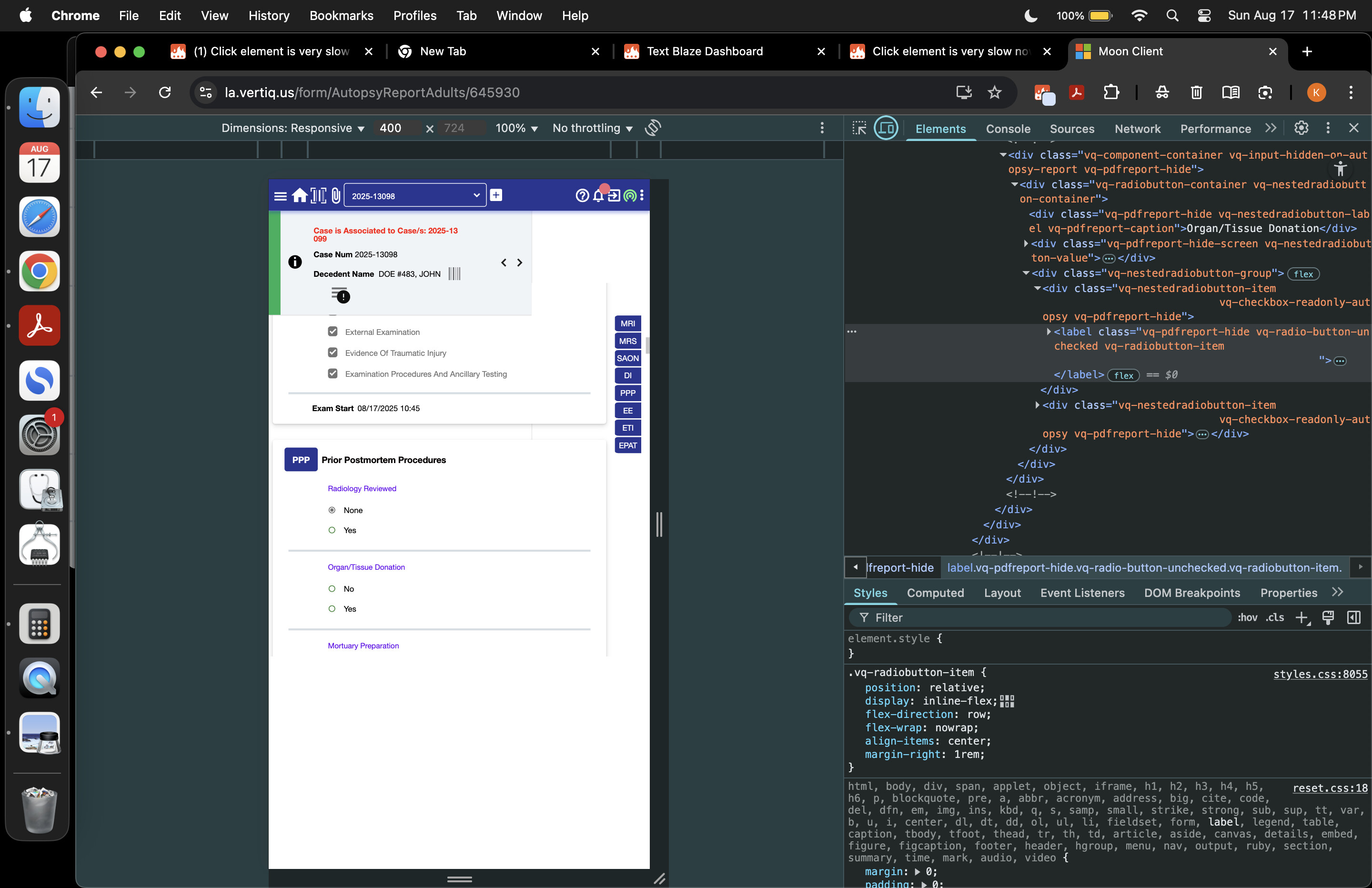

I inspected the No button on organ/tissue donation

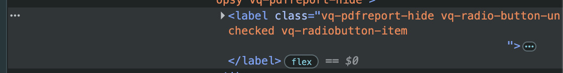

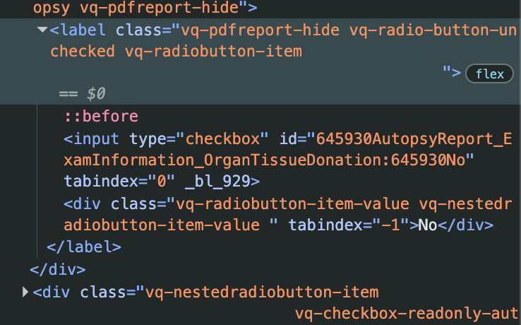

Thanks for sharing that. If you click on the arrow next to the highlighted label (shown below) in the HTML code, do you have an input element inside it?
Could you update your selectors to click on the input element instead? So, a command like:
{click: selector=#PriorPostmortemProcedures > div.vq-card-content > div:nth-child(3) > div > div > div > div > div.vq-nestedradiobutton-group > div:nth-child(1) > label}
would be updated to be:
{click: selector=#PriorPostmortemProcedures > div.vq-card-content > div:nth-child(3) > div > div > div > div > div.vq-nestedradiobutton-group > div:nth-child(1) > label input}
See the text " input" that I added at the end of the selector setting. Let me know if this speeds up the snippet for you.
Also, my guess is that this (faster) selector could be automatically generated if you used the "Select from website" tool. To do that, you can click on the radio input (the circle) next to the text "No", instead of clicking on the text "No" itself. Let me know if it works for you.
