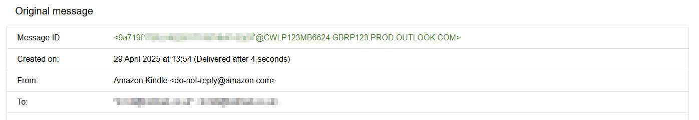

In Gmail, the MessageID of an email can be obtained when inside an email by clicking the 3 dots top right, clicking < > Show original , it is then displayed in the page that shows (see screenshot below). We would then manually copy this (I assume automating this part of the process isn't feasible via. TextBlaze)

This suggests that the "Original message" tab is not open anywhere in your browser window. I am referring to the page that opens when you do this:
Did you close it by accident while running the snippet? If not, a short video recording showing the issue would be great. You can also email it to me at gaurang@blaze.today

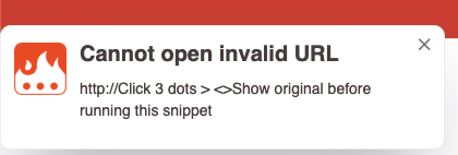

Yes, we can show an error like so:
{message_id=catch({site: text; page=https://mail.google.com/\*; selector=.message_id}, "")}{if:message_id<>""}https://mail.google.com/mail/u/0/#search/rfc822msgid%3A{=urlencode(message_id)} {else} Click 3 dots > <>Show original before running this snippet{endif}
Although it will look a bit weird as it thinks we're trying to open a URL, because we typed it in the omnibox:
