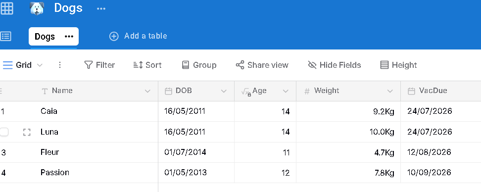

I have a table with date fields in DD MM YY format but when added to a snippet they change to YY MM DD. Is there a way to change this so they stay the same?

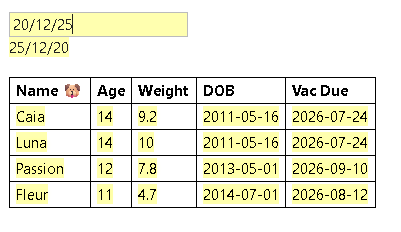

In the Data Blaze table there are two date entries that are just typed in dd/mm/yy format and when added to the snippet they change to yy/mm/dd
You can use the datetimeparse() and datetimeformat() functions to change the formatting of dates:
For example, to go from "dd/mm/yy" to "yy/mm/dd" you could use:
{formtext: default=25/12/20; name=d}
{=datetimeformat(datetimeparse(d, "YY/MM/DD"), "DD/MM/YY")}

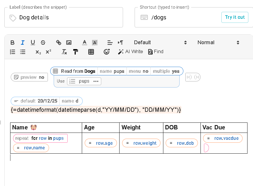

I added this to the snippet but it hasn't changed the dates in the table

I have tried replacing d with row.dob but that doesn't change. Do they need to be in a particular format

Does that need to be in the dbselect formula or seperate as in the image above
Also does the name in the default formula need to be row.dob as well and do i need a seperate formula for VacDue
{note: preview=no}{dbselect: SELECT Name, Weight, VacDue, DOB, Age FROM Dogs; space=5vwhNpRFkSJQZTjwT9tdJJ; multiple=yes; menu=no; name=pups}
{datetimeformat(datetimeparse(row.dob, "YYYY-MM-DD"), "DD/MM/YY")}{endnote: trim=yes}
Name {{^^%F0%9F%90%B6^^}} Age Weight DOB Vac Due
{repeat: for row in pups} {=row.name} {=row.age} {=row.weight} {=row.dob} {=row.vacdue}{endrepeat}
