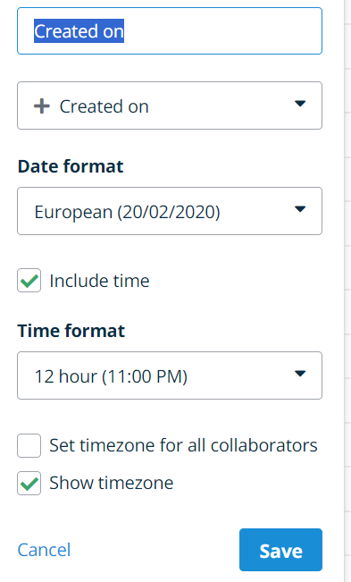

I have a datetime "Created On" that automatically records creation time of new record in the table.
"Created On" has the following setting:

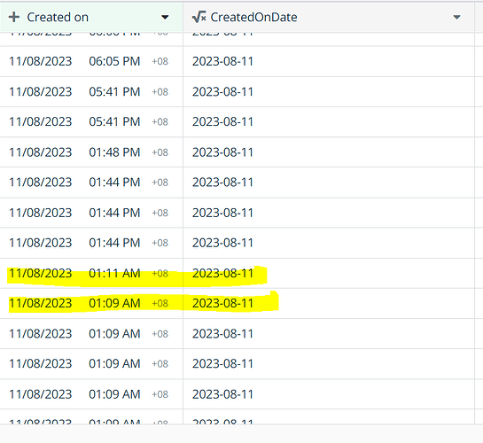

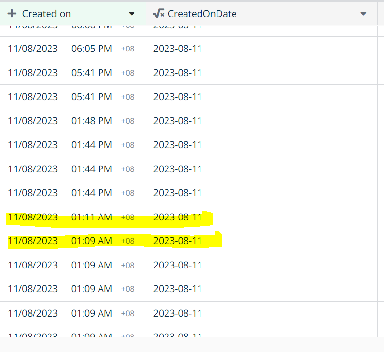

When I try to use datetimeformat or datetimeparse to copy and convert the data of this datetime field into new date only field, I realized the converted date is not correct, as shown below:
Formula i used: datetimeformat(Created on, "YYYY-MM-DD")
I suspect that timezone is the cause of this issue, please kindly advise me if there is way or alternative way to get the date only correctly in the Data Blaze? I am using this date only information to perform the countagg function in query so I only need the date part.

I understand that you're not able to format the "created on" date with respect to the timezone. Unfortunately, we only support UTC right now with the datetimeformat function. However, we're currently working on adding support to the timezone option to the datetimeformat function, which should be available in the coming weeks, I'll let you know once this feature gets released.
Meanwhile, your workaround of using the datetimeadd is perfect, thanks for sharing it with us.
