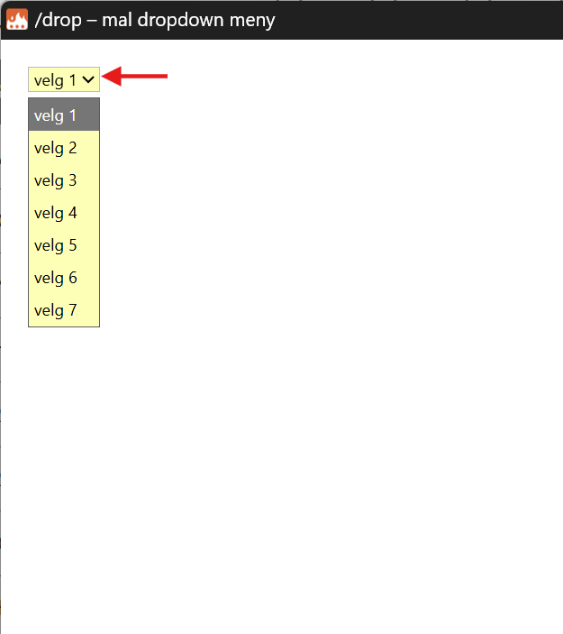

Is there possible to have a search box for the dropdown menu ?. It would be very helpful.
example:
I have menu with 50 different options, but know some of the name/words. So I can just start to type and it will show all the options with the words I type inn.

I was thinking more like having the search here, I can just type in 1-7 and get the match
Same with letters/words. Trying to keep it as simple as I can :slight_smile:
