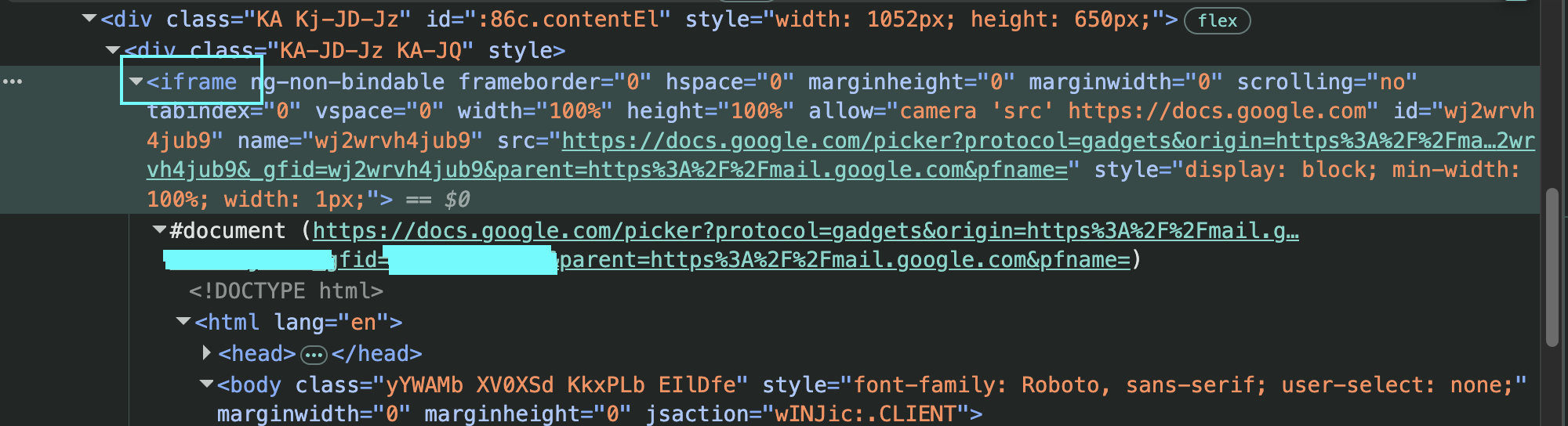

Thank you for following up on my post! Can you check the 'src' attribute of the frame in the attachment popup? You can do so by following these steps:
  1. Right-click inside the search field.
  2. Select the "Inspect" option - which is usually the last option in the menu.
  3. A panel will open on the right side.
  4. Scroll up a little until you spot the iframe's source, which would look like in this image:
As you can see, in my case it starts with "https://docs.google.com", hence that's what I used in my selector. Please share with me the screenshot in your case, so I can better understand what to use in your case.

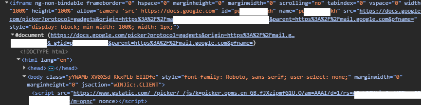

The inspect window gives me back a very simular image as you had:
It feels like it is just a minor adjustment I have to do, but which one?
It looks like that should have worked. Can you send me an email at gaurang@blaze.today so we can look into this on a meeting?
