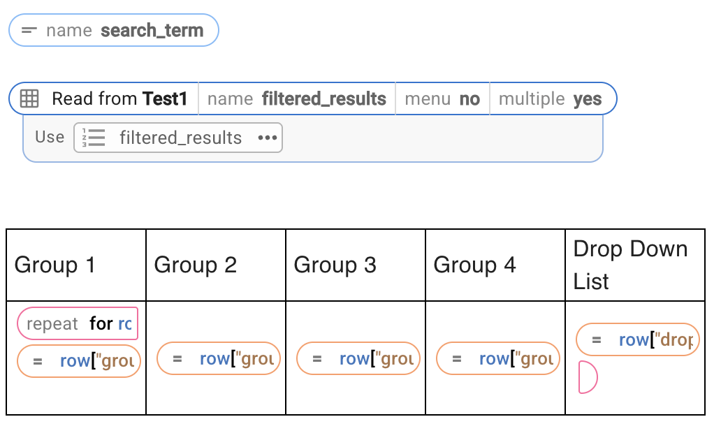

This screenshot shows how I added the rows to a table (this wasn't preserved in the shared snippet above)

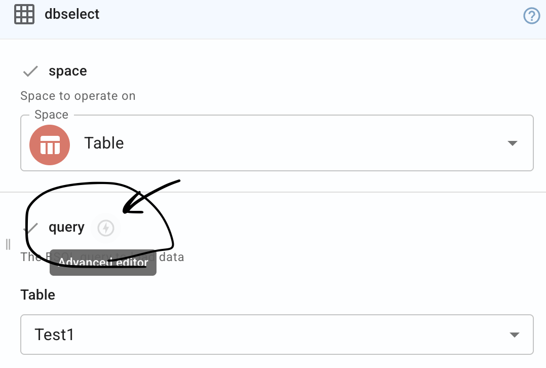

You will need to update the query itself to fit your table and rows, but the structure will stay the same. Let me know if you have any questions! Here is how you access the advanced editor to paste the query I shared:
